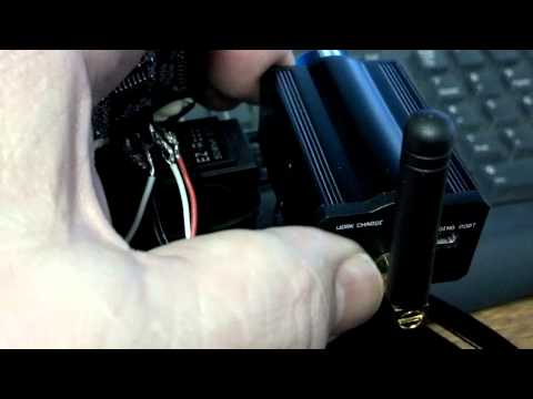

  • Can you please send me a link to the instructions to mod the camera power?
Thanks, Mike
@Mike, here's the LINK to the camera mod video
