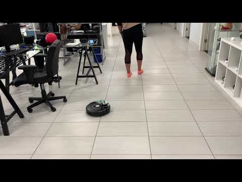

DJ did this a few years back with a camera on a roomba.  It is pretty much like what AthenaAI said.  In the video you can see the object or color used for tracking was the bright salmon (I'm calling them salmon) colored socks.
