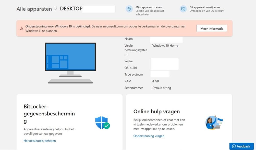

hi all
remember win10 is no longer updateble .

@athena
can it be diff voor usa and belgium ?
Yes - it can definitely be different between the USA and Belgium. Windows speech recognition depends on the exact speech language that is installed and available on your system, and not every Windows language pack (or regional variant such as nl-BE / fr-BE) includes a speech component. In short: some language packs support Microsoft Speech, others do not - so behavior can vary by country / language variant.
