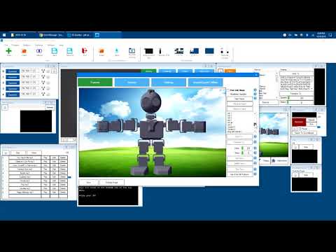

I'm having trouble reproducing the error by clicking and selecting a frame before editing. See this video and verify these are the same steps you're taking?
Yes. These are the same steps we’re taking. That’s exactly how I teach the process. Is it possible the software is corrupted somehow? Should I uninstall and reinstall the software?
