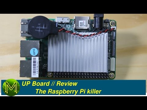

The suggestion is to put an embedded pc in your robot and use the web server for a custom ui to control ALL features of ARC - rather than partial features of what the mobile did.:) Then you can have a real robot doing awesome stuff rather than simple remote control of a mobile app.
