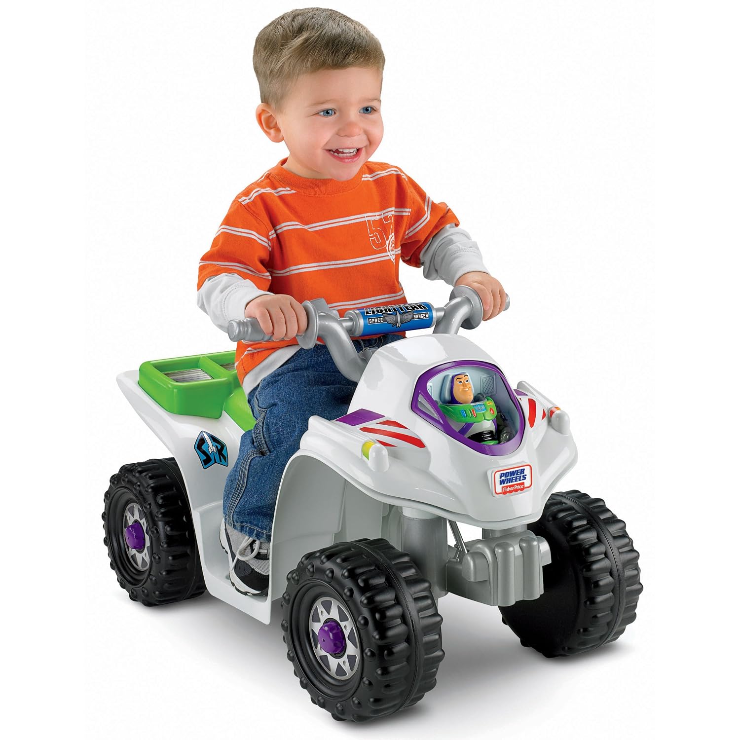

What I was day dreaming up the other day... You know aside from all those things guys normally think about.
Was cheap neatbook running ARC Andriod phone acting as wifi hotspot Netbook connected to the phone's wifi hotspot
Andriod phone reporting back to ARC its sensor data. Via what seems like the simplest method using query string script commands.
Minus the kid, plus a twelve volt battery. Use a dremal to remove unwanted plastic. Add the h-Bridge and steering gear. BLAM! You've got a robot that can carry sixty pounds of gear and can go almost anywhere it can get cell reception. Best of all the dang thing's piloted by Buzz Light Year.
Okay, I know... the devil's in the engineering. Just a thought tho...
What's wrong with leaving the kid on there?:)
