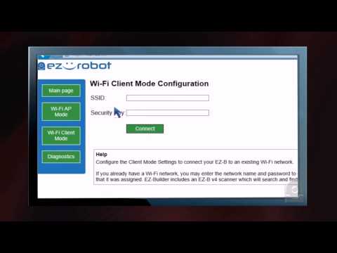

Are you sure you are connected to the EZ-B's WiFi and not your router?   If you are connected to your router, before putting the EZ-B in client mode, it will give this error.  See the connection troubleshooting tutorial linked above for more ideas.

@Erhijivwo Do you have a wired ethernet connection going to your computer? As Alan suggested, the EZ-B might be trying to connect to your router that shares the same IP address (192.168.1.1). Temporarily remove the wired connection and see if that fixes the issue.

I am on Windows 10 All my Windows Firewalls Off. - This is pretty dangerous affair.  Reset JD Robot. Power on and I Get a nice welcome message, suggesting I am going to have Fun, with a Flashing Blue Light. I can see EZ Transmitting on WiFi, at 192.168.1.2  - On my Android Tablet. I can even connect my Table to this connection.  So it seems happy transmitting somewhere.
I CANNOT see this in Windows PC, because my PC I WIRED via Ethernet to my Router on 192.168.0.xx network. My PC does not have WiFi. So my PC cannot see any EZ to connect to.  On my PC in ARC: I Try to scan across 192.168.1.0 --> 192.168.1.254  addresses in the Connection, but no IPs are found So I cannot get  any connections to EZ on  my PC
