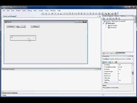

And here is a video i made for you to appologize for the time delay to respond:)
The code worked fine. I used the video to get the code as I am running VB Express 2010 and it kept on wanting to convert your 2008 files. After converting the "new" files were empty.
Setting up the componets on the toolbar was the biggest help.
