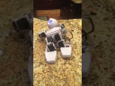

yes. I checked to make sure the ports were hooked up right. Watch the video of my Robot when I have the servo Fine Tune Profile loaded.
Here is when I try to get it to sit and stand back up.
Those videos help! Thank you for taking the initiative to share. The shoulder and servo are indeed not working correct. Use the Contact Us and provide a link to this forum thread in the warranty claim.:D we'll get you up and running soon!
