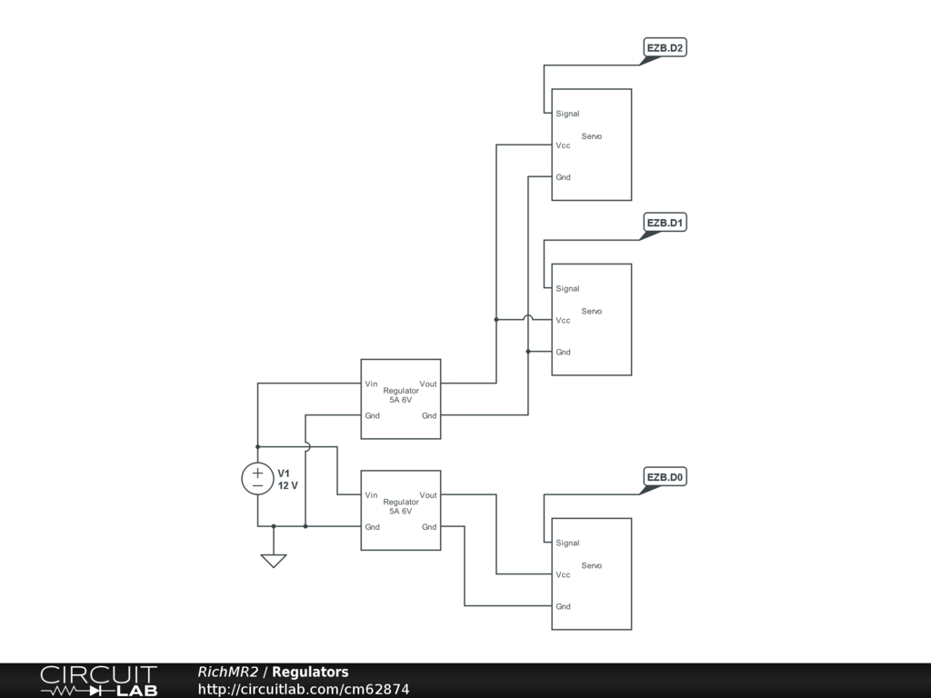

The EZ-B will power them but you get more out of them and avoid possible brownouts if you supply them with 6v, it depends on the robot at the end of the day, but supplying with 6v is pretty simple, I have covered it in my showcase for Melvin (I think it's called Project Hearoid) and plan to do a tutorial for a quick and easy method.

If your battery is 6v then it's very simple, basically just take a +ve and ground from the battery to the servo.
If you use anything else you need a 6v regulated circuit, I use an Etronix regulator. This connects on to the battery, from that you can take it to a distribution block, strip board or whatever and then on the servo, connect the red & black (or whatever colours the vcc and ground are) to the 6v supply.
#12
@feroze I would use alternative power like Rich is displaying on any high torque servo. You get much more holding power with 6 volts and there is the added benefit of keeping the brain of your robot , EZB, nice and cool.
