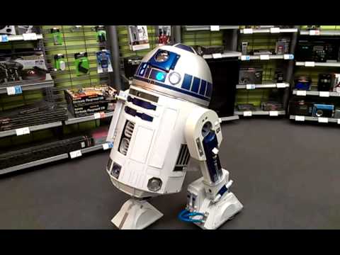

Hi I'm new here. I have been working with Arduino's for a while now. I have a full scale replica R2D2 I built. Its mainly controlled via RC but I have been adding autonomous functions. It appears that EZ-robot is the answer or best way to go a bought this. But I have a few quick questions:

If you'd like to see a short video of my project so far:

Saw your bot on a web site.... Nice job dude...
