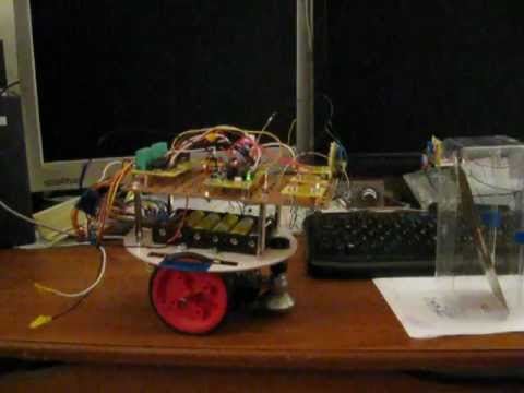

@elfege built a docking charging robot of his own design.  There should be a description here somewhere, although I am on mobile and haven't located it yet.  He doesn't seem to have posted it as a robot project.
