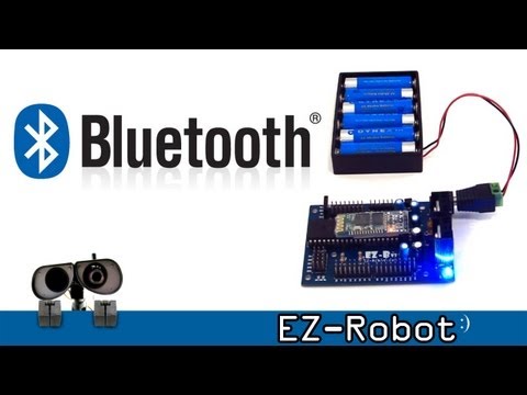

I had watched the above video and read the ezb manual (ok, maybe I ready it after trying first... ) I dont remember reading or seeing to click on the box showing the ip address to select the port (no drop down arrow on that bos so I didnt know that). I did know to select the lower port number but only after initially failing to connect multiple times. I may have connected to the higher port. When I initially installed the EZB v3, ports were created and I didnt pay attention to them.
