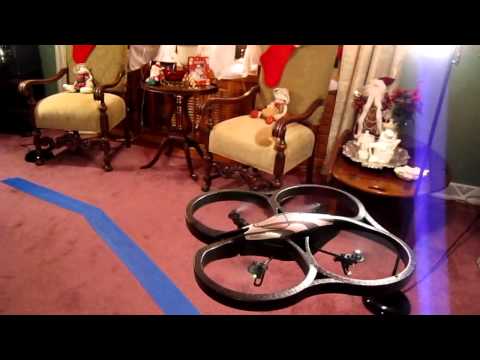

Yep, no hardware needed. Just connect to the drone over wifi and open the ar drone control in ARC to control it. To make it follow a line, you would need to do some ez-scripting referencing the camera control which will display the ar drones camera feed.

First, play with the ar drone control. This will show you the different capabilities of the control. Then, with the new plugin that adds a variable for the location on the camera grid, you would program in EZ-Script what happens when the line is in that zone on the camera grid. I believe you would have to install the plugin for it, but if you can find it it is very easy.
