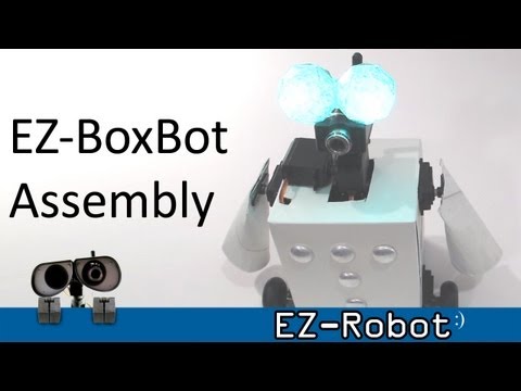

thanks guys, sorry thetechguru, i was in a rush when i was typing so i meant a youtube vid, but anyways here it is
