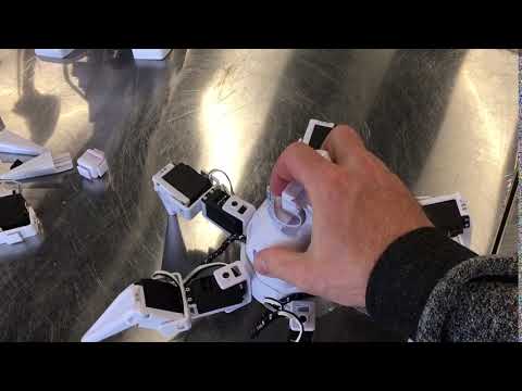

Upfront my apologies for a somewhat embarrassing question, but I am a total newbie with EZ robots. A parent at my school donated a Six to get some robotics classes going, yay:). So today I followed all the instructions to assemble it, got it to connect etc. In pose view I can access all 12 servos and they all seem to be properly wired. What I can't figure out right now is the fact that directions are reversed, if I choose move left, Six moves to the right, if its forward Six moves clearly backwards. What little thing do I keep overlooking? I am using the app on an Android tablet.
Without seeing a photo, my guess is that the servos nearest the body are all mounted upside down, so they are going the opposite direction of the commands.

Oh god ... eyeroll that is exactly what I did. Me "following" the instructions. I think I could have stared at the robot for another hour not noticing it. Thank you so much for the quick response. This platform is awesome.
6 servos mounted upside down.
