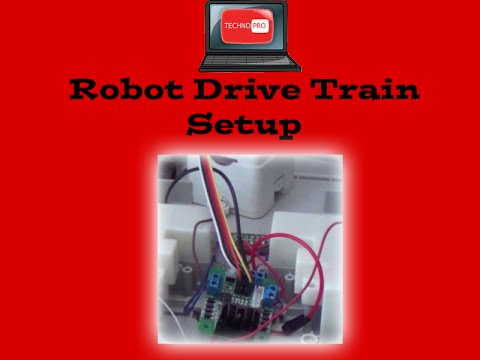

Ok. So. People who might be unsure how they're supposed to connect h-bridges to the ez-b V4 will wanna check this one out for an idea.
I made this video to show people how my Dewy drivetrain is currently setup. If it helped anyone, let me know! If I was wrong at any point in the video leave a comment on it.
Thanks guys, And I hope it helps! Tech.

@Techpro, Very good tutorial on h-bridge with v4. J
P.s. I will make a video with three h-bridges same wiring to each h-bridge and v4. J
Thanks J. Thought I would post it cause I forgot to a month ago... blush:D
As you see in the picture three h-bridges, they are all on.
from another angle...
in this shot please note the six bolts. From each h-bridge 6 wires, each bolt has four wires, 3 in and 1 out. The out goes to the ezb v4 controller. This way only 6 ports on the ezb.
NOTE: you could use something else in place of h-bridges... but that is what I had with my ezb v3 controller.
I use these battery packs, GB can carry six and I still have room to carry other stuff. Like jd sitting on GB or six.
If you have questions, leave reply.
