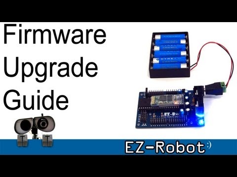

There is also further information including a video available in the tutorials section of the site here
For your own convenience here is the video, just click play:)
