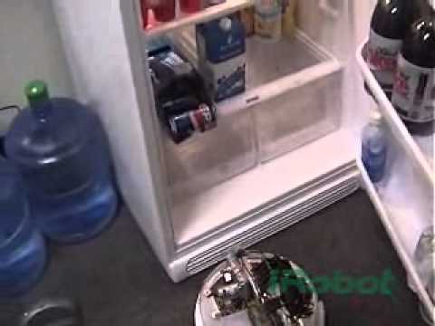

If you are looking for some arm designs, take a look at some youtube videos like this for some ideas
